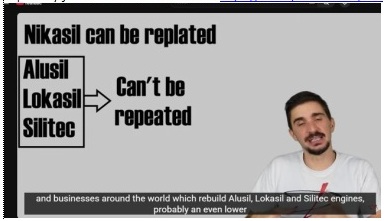

Příspěvek od Vrooom »
pavproch píše: pon 29 pro 11:42 NENAPADÁ EŠČE NĚKOHO NĚJAKÁ DALŠÍ MOŽNOST HODNÁ ZASPÁNÍ DO BLBNÍKU?
Ja ti to uz psal. Tady jsou nejake postrehy nekoho kdo se zda vyzna.
Je to k te V8 v M3 (taky alusil), ale ani ty novy bloky od BMW asi nejsou zadna hitparada a tady ho rovnou pouzili na pokusy ...
https://www.m3post.com/forums/showpost. ... stcount=21
As an aside, note, we discovered that BMW does NOT use torque plates when it bores and hones alusil cylinders, meaning that those cylinders are materially distorted out of round once cylinder heads are bolted into place. Not out of spec, but enough to be material to a high performance engine in our opinion. As a result, we re-bore, re-hone, and re-expose even brand new blocks from BMW. And we use torque plates on both banks simultaneously!
U te V8 mi prijde fajn, ze to je motor co se casto generalkuje, takze k nemu bude bambilion informaci. Ta N52 neni takovy exotika, tak to lidi asi nechaji radeji umrit ...

Příspěvek od pavproch »
a)
b)
Já věřím tomu bé.
